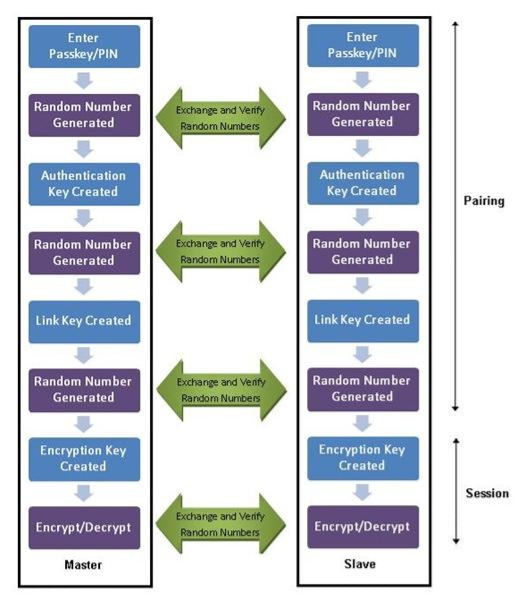

Bluetooth security is based on several principles. The first is the abrupt frequency change. The frequency change algorithm is available to the master and slave devices but not to third parties. The second is the secret key; devices exchange it during pairing. It's used for authentication and encryption (128-bit). There are only a few Bluetooth security modes. More details about them:
